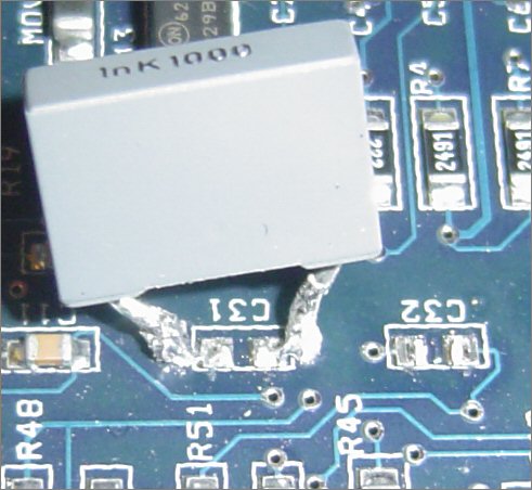

Marivs escribió:C31 y D24 fueron los que tube que cambiar para que no se atocinase a Hi RPM ...
TELVM escribió:Yep, posible gremlin con estos dos elementos ... Anyway con estos dos ya nos rascaríamos cuando picara, if (corte a 4000 y tal :cuñao: ).
Llegó el momento de rascar señal VR para que suban las rpm :lol: :
Imagen Imagen
"... i had intermittent vr signal with my v3.0 board, but thats because i had the wrong capacitors and diodes on the pcb. (pre oct 08 kit) specificaly, d24 needs to be a 1N4148 not a 1n4001. also C31 needed to be a 0.001uF and i removed C32.
... the problem i was having was some kind of phantom 2500 rpm rev limiter ... :idea: "
(Exactamente mi gremlin).
"VR Sensor: In addition to setting the VR circuit potentiometers properly, there are a few others things you can try with the VR circuit if you have issues:
- If you experience tach drop-outs at higher rpms when using the VR input circuit, you might need to replace the diode D24. The issue is with the reverse recovery time of a 1N4001, it is as much as 30µsec. You can use a 1N4148 diode (1N4148DICT-ND from Digi-Key) which is much faster (4.0 nanoseconds, or 0.004 µsec) and should solve this problem.
- You can remove the capacitor C32. This is the capacitor in parallel with R47. Although removing this capacitor may cause a ever-so slight phase shift, it will probably not be noticeable.
You can reduce the value of the C31 capacitor to 0.1µF to 0.001µF to improve the high frequency response of the input circuit".
Es posible que en mi 357 el diodo sea de serie un 1N4148, así que voy a empezar cambiando el condensador C31 por otro de 0.001µF, y quitando el C32.
Por si las flies: Lo de 'remove C32' imagino que significa extraer el condensador y puentear directamente los contactos, no dejar ahí abierto el circuito. ¿Gñ?
Yo diria que dejarlo abierto. Si no, hubiera especificado "jump" or something like that por algun lado. Y es perfectamente factible que quede abierto ;)
Si quitas el condensador y puenteas, anularias tambien la resistencia en paralelo, por lo que sera solo quitarlo.
My two cents :wink:
Y además lo que proponéis cumple la ley del mínimo esfuerzo :cuñao: , así que solo extraer.
¿Cómo averiguo si mi diodo D24 es o no un 1N4148 :-k ?

Comprobando los numeros con una lupa/microscopio, otherwise, sustituir por el 1N4148 y salir de dudas.
PD: Los componentes SMD tocan mucho las narices :rolleyes:

Fumador empedernido y gañán declarado en soldadura tras cinco minutos utilizando la punta de la innombrable :ein: :
357 C31 y C32 mod RPM 001.jpg (59.84 KiB) Visto 4763 veces

La de diosss, un condensador SMD vasco!!! :lol: :lol: :lol:
Voy a poner mi pega como "pro" por lo que pueda valer... con la poca superficie que hay en un pad de soldadura smd, meter un bicho tan grande tiene las siguientes contraindicaciones:
- Necesita mas calor para soldar, por las patillas mas grandes, te puedes fulminar el pad
- Si por contra, por ser consservador, no calientas suficiente, tendras una soldadura fria
- Un componente "tan aereo" soldado en unos pads tan pequeños será ampliamente afectado por las vibraciones, mala cosa para las soldaduras :!:
Cawendiox, yo no tengo NPI de estas gaitas, le pedí al de la tienda letrónica un condensador 0.001 mF y me dió ese mamotreto. Le pregunté 'y no los tienes más grandes cacho cabrón' y me dijo que nó. Así que mamotreto p' alante oxtiax, tanta txitxirivaina letrónica joder :cuñao: .
pues si tiene mala uva el de la tienda de electronica, incluso el ke yo puse era mas pequeño :cuñao:
pero ya que lo has puesto asi, recomendable seria ponerle un poco de cola caliente de esas que usan los electronicos :rolleyes: para darle un poco de sustento
OMFG!! :rofl: :rofl: :rofl: :rofl:

Coño nos ha jodido, eso si que se suelda, lo jodido es soldar un SMD de verdad sobre esos pads y no acabar encharcandolo todo en estaño o hacer una pieza maciza :cuñao:
MarteDJ escribió:pero ya que lo has puesto asi, recomendable seria ponerle un poco de cola caliente de esas que usan los electronicos :rolleyes: para darle un poco de sustento
¿Algún sucedáneo McGiver de andar por casa podría cumplir? ¿Chicle :cuñao: ?
chicle podria colar :-k
Muereeeee :badgrin: .
